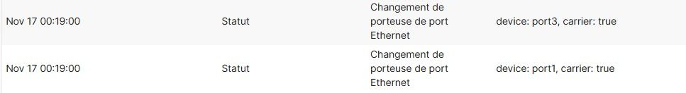

This morning, I arrived at the office and noticed that my Meraki device had a solid orange LED. I was unable to connect locally. I accessed the cloud via an alternative internet source and saw a notification that the connection had been down for over 24 hours (I was away for the weekend).
Could anyone advise on the next steps to resolve this issue? I have checked the event log, but I'm not sure how to proceed.
