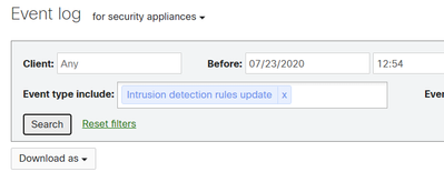

Just the info below of when the signatures have been updated.
I think you could do this by scanning the event log.

How about this type?
From the GUI i can get it and below is an example
snort_rules_version: 2.9.8.3, source: ids-vrt-security, rules: b3e3f2e7a2e5b7b509a7dd15e5ef9e679d225a20

I'm not aware of where you would find should a mapping.
