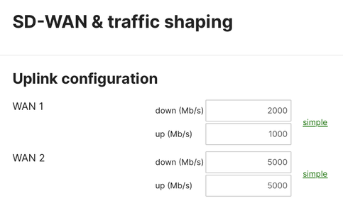

Is your uplink configuration set according to your ISP bandwidth speeds?
Dashboard > Security & SD-WAN > Configure > SD-WAN & Traffic Shaping
jrhead
This is what I currently have set but have tried 1000 for both directions.
RWelch
If your ISP is 1Gig pipe you'd def want to set it at 1000 up/down so the MX knows it's bandwidth limits.

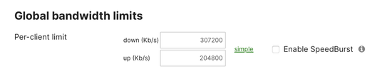

What is the per-client limit set under Global bandwidth limits?
jrhead
Unlimited
