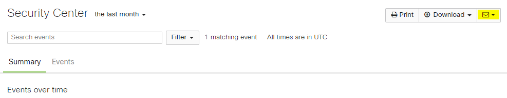

You could also setup scheduled reporting via e-mail about the security events:
