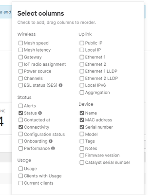

Hi Team Meraki I would like to know how do I search for active serial numbers of the MR44 APS's on a life netwrk please advise.

hi @Nico2 - go to Wireless > Access Points and click the spanner tool on the right hand side of the dashboard.  Then under Status select Status and Serial number as per the below screenshot.
DarrenOC
That's the spanner icon 🙂

DarrenOC
hi @Nico2 , this is within the Meraki dashboard.  On the left hand side window pane under the respective network select Wireless > Monitor > Access Points.  Dependent on which version of the dashboard you're looking at (new vs old) you'll either see a spanner or cog wheel.  Select that and follow the instructions above.
