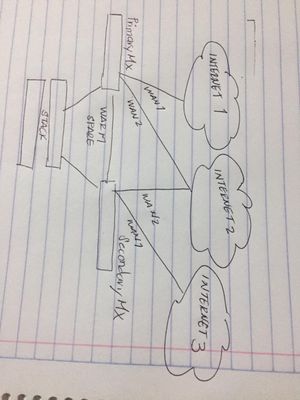

Hi Team i need your help, i need to do MX84 Warm Spare but my problem begin becouse my costumer has three internet. so i need your support for this becouse i just find information about warm spare but just using two internets.
i attached some draws with my desig.
if you had some link related please share becouse its kind a hard to find something like this

Yes that will work. Note that ISP3 will only be usable if the primary MX has failed.

Hi Jorge,
Agreed to @PhilipDAth.
I too do not see any challenges with the proposed topology.
I hope you have already referred the following Url
https://documentation.meraki.com/MX/Other_Topics/Warm_Spare
Ajit

Thanks so much, i think the point of this its becouse i missundertand the concept, Meraki Warm Spare works only with two ISP at the same time, if i want to enable more then 3 or 4 ISP we need to use MX separate and its different for Meraki warm spare concept and recomendation.
