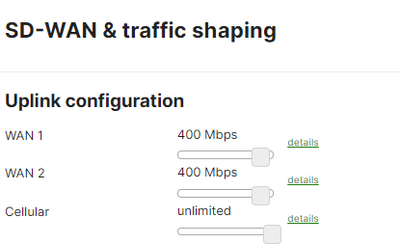

It's only effective if the WAN bandwidth in the Uplink Configuration is accurately configured:
For my use case therefore, a combination of each of these is applicable.
