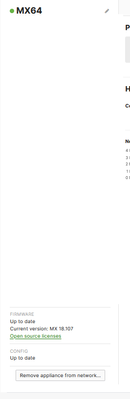

Do you think the firmware has changed?

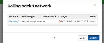

I had some issues with version 18.107.2 regarding printers. I suggest you to downgrade to some other version available in the dashboard. If this is not possible, I suggest opening a ticket with support.
athan1234
A model citizen
 Do I have to upgrade from templete?
If It's on a template yes.

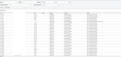

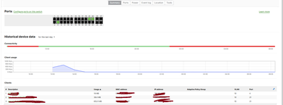

I'mwatching the switch is KO. Yesterday, I witnessed a similar incident in which the center had connection and the SW was KO was Any idea?
Port 23 ---MX
Port 4 - Escaner printer
MerryAki
Building a reputation
I can barely read it, does it say offline on that port? MX and the switch are connected directly?
Try to run a cable test on the switch if possible or just checking the cable physically. I know thats some effort but for troubleshooting purposes it might also be required to have an engineer on site.
Sometime there were also untold changes during maintenance times, which do produce some additional issues. For instance changing certain physical connection/s during switch/config updates.

Yes directly from mx to SW
I'm attempting a cable test on port 23, but I'm not getting any results.
I am seeing traffic
Yesterday i made a downgrade for the templete

that screenshot shows no uplink...

The scarner dosent work . I made a downgrade version, but it is ineffective.
