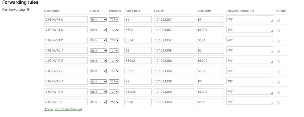

Hello members of the community. I'm having an issue with only one port forwarding rule that we use for remote log view of one of our NVR systems.
I added some port forwarding rules in our Cisco Meraki MX84 systems without problems. I noticed that only one of the port rules is not working. I checked every setting and is still not working.
Using a port forwarding tester I confirm that only 5554 port is not working.
I appreciate your help and knowledge.

Was the port configured correctly? Could you share the configuration?
DSP_IT
All the forwarding rules are working except the rule " VTG NVR1 C" that should open 5554 port.

@DSP_IT I know this sounds silly, but can you confirm that the port is definitely open on the internal host?
DSP_IT
Nothing sound silly when we are trying to solve a problem, so thanks for your answer. The port is open on that terminal. Is already opened on Windows Firewall settings, is opened inside the Camera Server (attached Image).  The most weird thing is that is only one single port.Ports.jpg
cmr
If it isn't too disruptive, can you try moving it to another port?
DSP_IT
I decided to restart the Camera Server and now is working. Thanks @alemabrahao and @cmr for every response.
