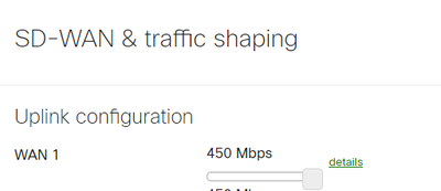

The first thing you need to do is configure the uplink WAN upstream and downstream speed parameters.  You'll need to measure these, and then configure the settings to match.
https://documentation.meraki.com/MX/Firewall_and_Traffic_Shaping/SD-WAN_and_Traffic_Shaping#Uplink_b...

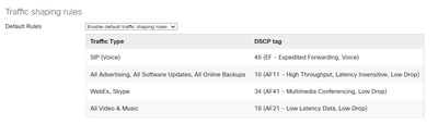

What are these Default Rules doing anyways ?
Do they mark packets or they respect marking and queue/schedule packets accordingly ?
Thanks
Correct.  If you have applications that need QoS they can usually mark their own packets.
I can't remember when I last had to configure QoS on a Meraki MX - the default rules work great.  Meraki simple.

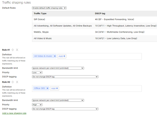

@PhilipDAth All right so problem solved for Teams.
Now what about Netflix and YouTube. We cannot completely block them for business reasons but we also don't want them to hug all their bandwidth.
How would you proceed ?
Custom rules and put them in low priority ? This is what I have in mind :
I wouldn't normally both with priority.  I would just set a bandwidth limit.
