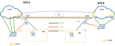

I currently have a connection between Site A and Site B.
It's a point-to-point connection on Gi0/0/0 (both sides) and a subinterface Gi0/0/0.100 has been configured, and a dmvpn tunnel (tunnel 3) is configured on this subinterface, advertising the network of both sites via EIGRP.
The networks arrive and pass through the Firewall to then enter our network.

Architecture >> ISP >> Firewall >> Switch | Router for communication between sites
With Meraki only at site A and without dynamic routing between tunnels, I do not know how I will maintain communication between the two units.
In this scenario, any guidance? Site A and Site B need to connect.

Also, traffic flow. Do i understand correctly?
Site B client > firewall inside > firwall subint to vpn router > site A router > firewall subint to vpn router > Site A inside ?

Perfect! About the architecture you understood perfectly.
