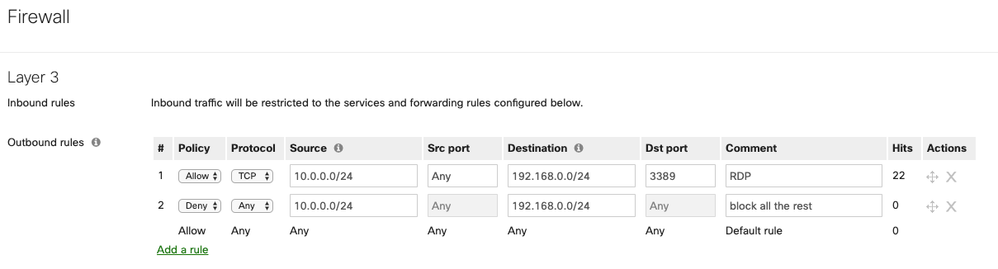

On the MX84 goto Security & SD-WAN. under Configure click Firewall
under Layer 3 you can add the following

Is this what i am supposed to do on the MX84
OLD VLAN 10
NEW VLAN 20
Firewall Rule
Source 10.10.10.0/24 Deny All except 3389 to Destination 10.10.20.0/24
Source 10.10.20.0/24 Deny All except 3389 to Destination 10.10.10.0/24
cmr
You'll need to allow 3389 as per @Wickus comment for both then underneath deny all for both, so 4 rules in total.
