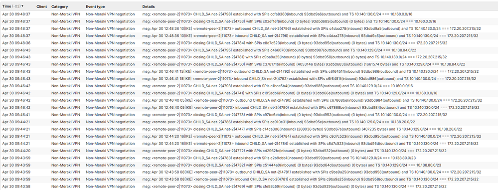

Guys, Morning.
After change to IKEV2, i see in the event logs, many register VPN no-Meraki.
Verifed the uplinks in the firewall MX, no latency, drops in the links, no register.
Any recommended changes to the peer settings?
