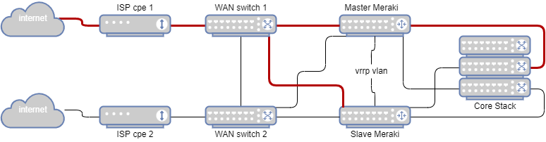

Here is how it looks. Red is active internet connection.
Could be something on the WAN switch blocking the VIP like an access list. You could do a capture on the ISP side of the WAN switch to see if the ping goes out to the ISP. On the ISP side, if your VIP is part of the /29 attributed to you, I don't see any reason for them to be blocking the VIP.
