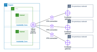

Hello, I am trying to set up multiple Site-to-Site VPN connections from multiple on-premises sites to a single AWS VPC. I have done this years ago in Azure successfully and can see a single entry under the non-Meraki VPN peers entries. Then in Azure I created the multiple connections with same password and everything worked out ok.
I am now in my AWS VPC console under the Site-to-Site VPN Connections menu and I am trying to figure out how I am supposed to do this. Am I missing something?
I would prefer not to use a vMX at this point as I have my VPC and its environment up and running to already connect to one site via site to site VPN. I am trying to add more MX sites to connect to that same AWS virtual private gateways. How do I accomplish that?

Thank you so much for your replies. I ended up figuring it out. Maybe I wasn't clear in my original post. I managed to get S2S setup. But trying to do multiple S2S to a single VPN in AWS was challenging to me. Until I found posts from others about using the tag feature under the Availability tab in Meraki dashboard to separate the ipsec profiles.
