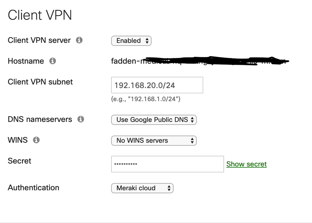

1- enable Client-VPN on the dashboard
3- Create the VPN following up the Step-to-step instructions for mac on the Meraki website.

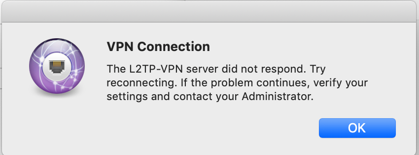

4- that what I get when I try to connect:Screen Shot 2019-05-04 at 12.27.27 pm.png

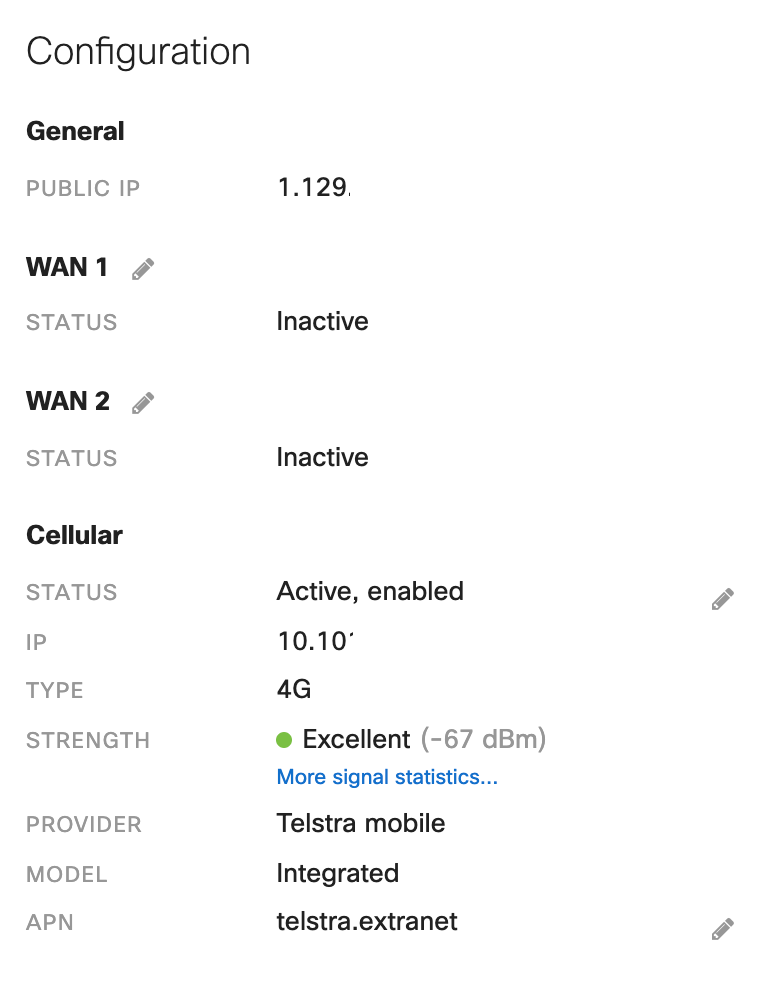

Keep in mind that on the Appliance status > uplink  the public IP is different the ip on the cellular.
Tihs is almost certainly an issue with your cellular carrier filtering inboud traffic to you.
With any luck you carrier will offer an APN where they do not do this.  If you Google the name of your carrier and terms like "L2TP" or "VPN" and "APN" you might be able to find this.
Once you have an APN you can use you'll need to open a support case and ask them to configure the MX68 to use that APN.

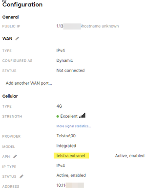

I have a Telstra mobile SIM that I have been advised has been configured to be used on the telstra.extranet APN and I have added the APN name to the Uplink page as shown in image as well.
no luck for me though....

Yes I think this is the case also.  I have done caps and yes I came to this conclusion and that's what lead me to this forum thread.  The image shared by the other forum user is very similar to what I see in the Uplink status page on Dashboard. WAN Interface has public IP and Cellular Interface has 10.x.x.x IP.  My conclusion is CGNAT is in use and likely filtering inbound traffic.
This is why I arranged to move the 4G SIM to the telstra.extranet APN.  I updated editable section for APN(is this just a tag?) to be telstra.extranet but as I mentioned earlier, is there something else that need to be done by Meraki to make the MX connect to this alternate APN ??

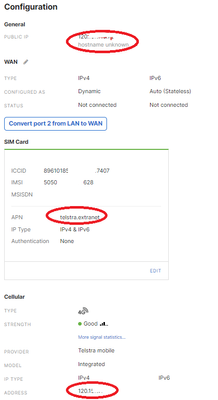

For anyone on a MX67C/MX68C running into issues with integrated cellular and custom APN's, try upgrading to MX 17.6 firmware. I was running into lots of issues with the integrated cellular on older firmware: some devices I could not set a custom APN myself (had to be set on the backend by Meraki support), and none of my devices would seem to take the public static IP APN from our cellular carrier (would never get the assigned public IP, always got a CGNAT IP).
