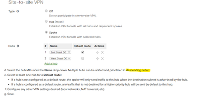

Hi @alemabrahao ,
      I already search the possible document for these use case, but I confuse regarding priority hub on Meraki Auto VPN. How do I setup the priority? Do I set last Hub datacenter for descending order.

Hi @AYEN ,
You just click and hold the cross-arrows, moving up the Hub you want to have the best priority.
The number is the priority ; the hub on the top has the best and the others would be back up / fail over.
It's very simple, the priority is from bottom to top according to the numbering, that is, number 1 has greater priority over number 2.
