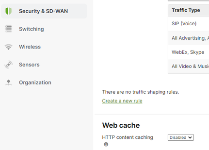

One possible fix, reported elsewhere on this community is to check that web cache is disabled as below:
CyberDingo
Thank you for the recommendation. I tried disabling Web Cache and it still shows the same problem.
