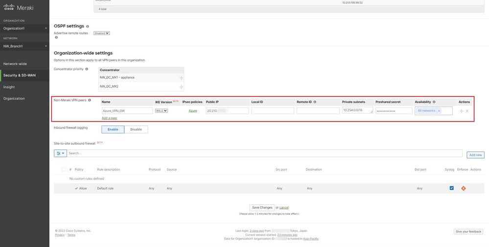

Just in case, I verified it again.
I will share information.

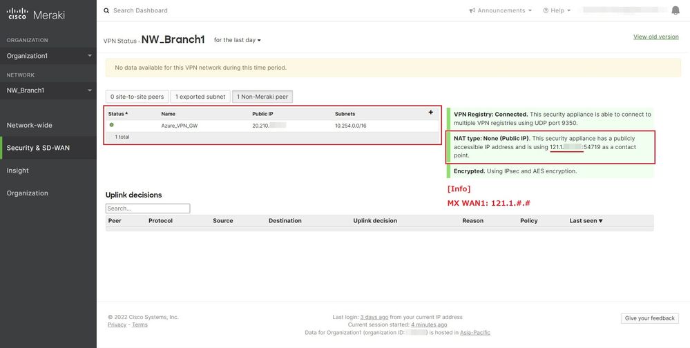

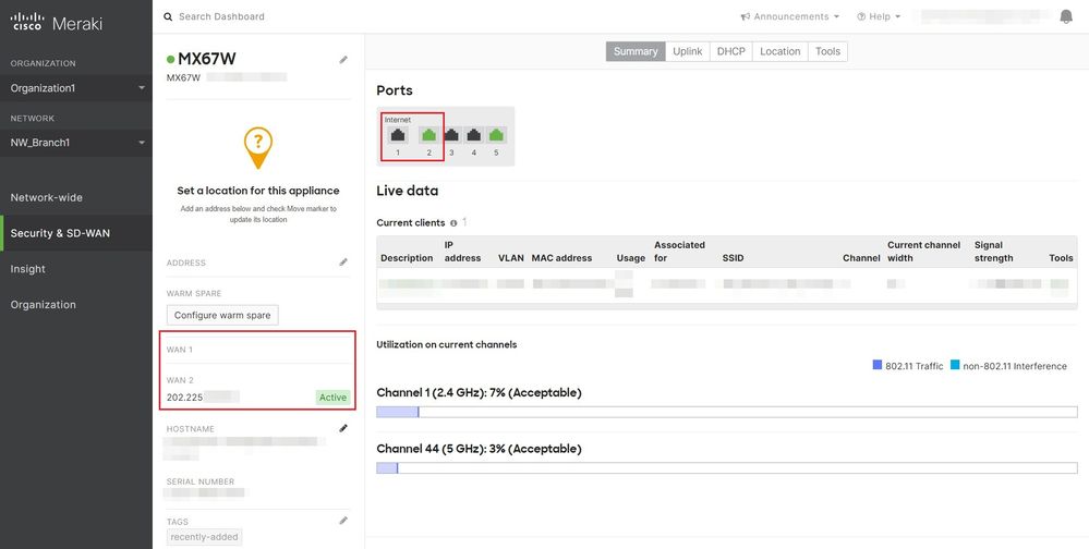

[MX Settings]
Non-Meraki VPN Peers: To Azure Gateway Address
[Addressing]
MX WAN1: 121.1.#.# (PPPoE IPCP)
MX WAN2: 202.225.#.# (PPPoE IPCP)
Azure VPN Gateway: 202.210.#.#

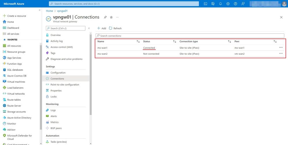

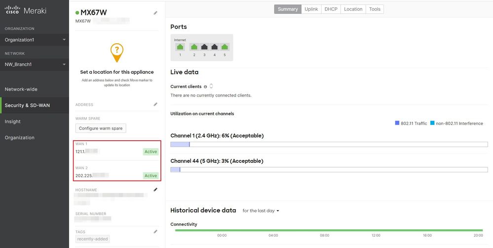

[Status: WAN1 Up & WAN2 Up]
This is a normal situation.
Azure VPN Gateway establishes a VPN tunnel only on the WAN1 side.

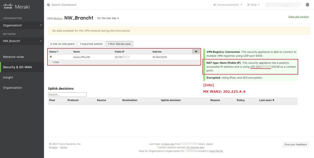

[Status: WAN1 Down & WAN2 Up]
This is a situation in the event of a WAN1 failure.
Azure VPN Gateway failover from WAN1 to WAN2.

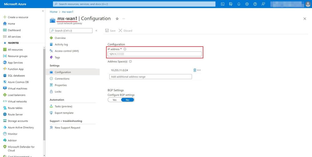

So, I realize this thread it way old, but this is the only example online I can find.
Trying to implement what was done above, and Azure complains about the overlapping subnet on the local network gateways and won't allow the 2nd connection to be added.
Was there some trick for adding this in Azure, or did they change it so that it is no longer possible?
