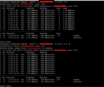

When testing between the Pi's via NAT rules, I get the following performance:
Both ways the throughput is around 888Mbit/s, which is fine.

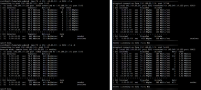

However, when we try to do it via AutoVPN, things change...
As you can see, there is a discrepancy of about 100Mbit/s between sending or receiving...
Neither me, my colleagues or Meraki support can explain this behavior. I've gone through the entire configuration multiple times, but i'm stuck.
