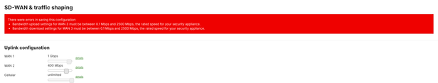

Is there a requirement to enable the BACKUP WAN and configure this unused WAN in order to change the WAN1 ISP speed?
Seems a bit odd that it won’t allow me to change the WAN1 configuration (upload/download) until such time that I configure the backup WAN that’s not being used.
Thanks for any feedback you have to
share.

It won't accept any changes regardless of what speed I set it to because WAN3 has NOT been configured.
 I get the same error whether adjusting via slider or manual entry.

@MRCUR Tech Support sent me these instructions that fixed the issue for my particular setup (7/26/24) and it DID fix the issue:
Thank you for contacting Meraki Technical Support!
Can you temporarily enable the WAN3 Backup feature, modify the WAN 1 bandwidth settings, and then disable the WAN 3 backup feature, and then try modifying the WAN 1 configuration again just to ensure the WAN 3 backup feature is no longer being referenced?
Keep in mind, when temporarily enabling the WAN 3 backup feature, the physical port usage will change to the following:
On the MX85, MX95 & MX105 - The Fourth physical port is the designated backup port. Physical ports 1 & 2 become designated WAN 1 and WAN 2 ports.
