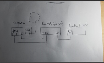

From the sophos 1/Lan port is connected to a Cisco switch on port 2, Then Lan 4 on sophos is connected to port 3 on the Cisco switch(2960) while the port 48 on the cisco switch(2960) is connected to a router F0/0 Port. So what I have done presently is to connect the Meraki MS120 to port 5 on the 2960 switch as a trunk port. So I want to setup the MX68 to this existing network. The below is a rough sketch.
DarrenOC
Hi @emmaozoms , the question has been asked before but do you have a spare external IP?  If so you can have both firewalls running in parallel with each other.  If your WAN provider has a spare Ethernet port on their NTE you can connect the MX to that.  If not, and there’s just a single port place a switch in front of your firewalls.  This will give you the additional port capacity. Run both firewalls in parallel for a period until you’re ready to migrate everything to the MX.  If that’s the intention?
