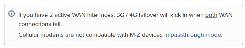

Nope, you're not going to be able to do what you want with an MX. It will always require an IP on its cellular interface.
I don't think the cellular interface is even supported in pass-thru mode... Let me check that.
