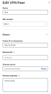

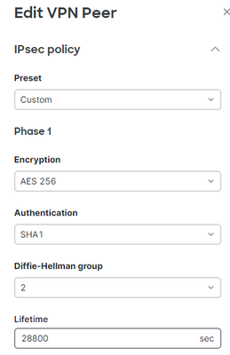

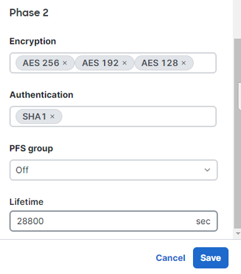

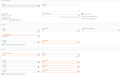

Dear Team,
We have MX64 and we have configure site to site VPN tunnel with Sophos XG135 but tunnel not getting up .
at MX64 side internet is connect on wan port from ISP router , WAN port is getting DHCP IP from ISP's router.
and at Sophos side have directly static IP .
Both side IPsec profile and PSK is same but still not getting connect .
Kindly helpful for the same , waiting for you reply....
