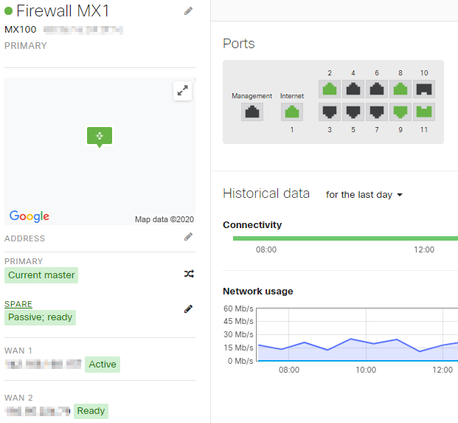

On MX1
Ports 1 & 2 are connected to ISP1 and ISP2.
Port 9 is connected to an onsite web server (configured as a DMZ)
Ports 8 and 11 are each connected to a different one of the stacked switches.
So far so good

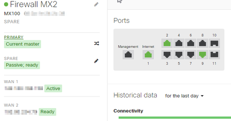

On MX2
Ports 1, 2, & 9 are the same as above.
However, as soon as I try to connect port 11 to one of the stacked switches, our Internet goes down instantly.
Since there is no connection at that point to the cloud, I can't capture packets from that port, can't see what is happening.  As soon as I disconnect it from the stacked switch, Internet is back up.

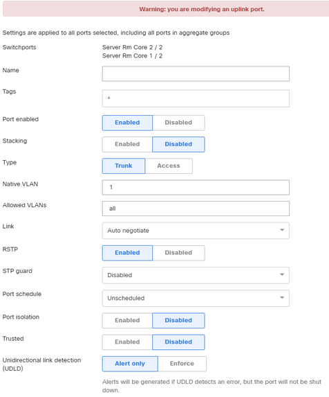

How are the ports that connect mx and ms425  configured ?
