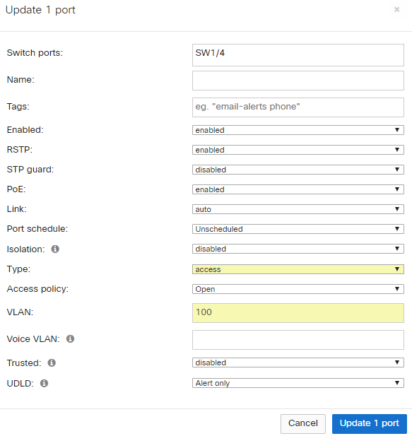

  • Set the port to which the client is connected to access for VLAN 100:

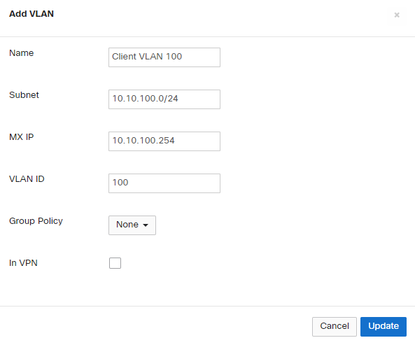

On the other end, the MX you'll have the client VLANs defined, here's an example for one of the VLANs. 10.10.100.254 will be the MX's IP address and default gateway for the clients:

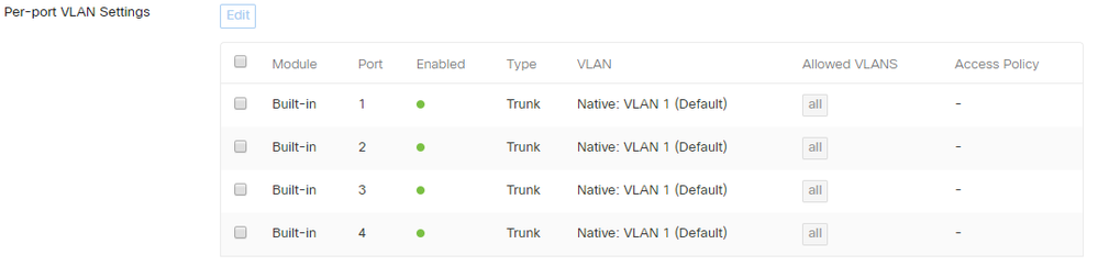

By default the ports on the MX are already configured as trunks with all VLANs allowed so no changes are necessary there:

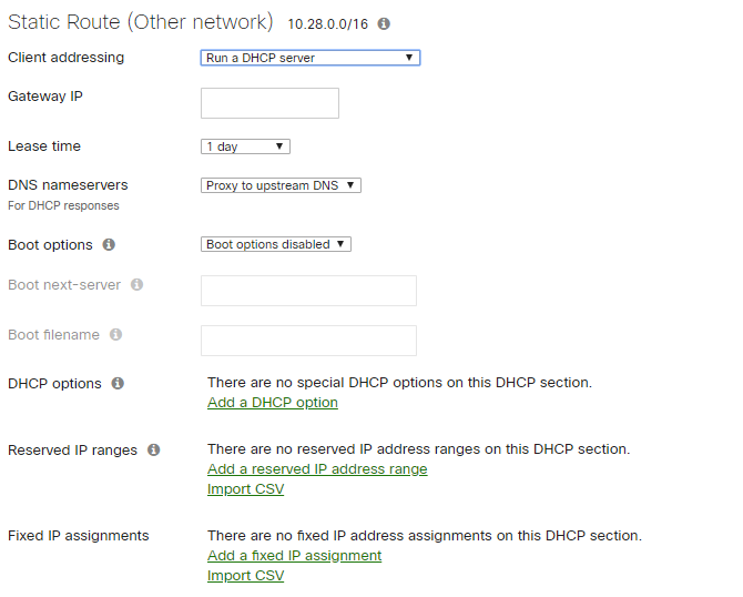

On the MX there will be a static route for those VLANs pointing to the MS as next hop. For the subnets that the MX has static routes for, it will also have a section in the DHCP server. It looks very similar:
