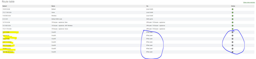

Oh, so on the mx, those subnets should have static routes?  heres the routing tableCapture.PNG
