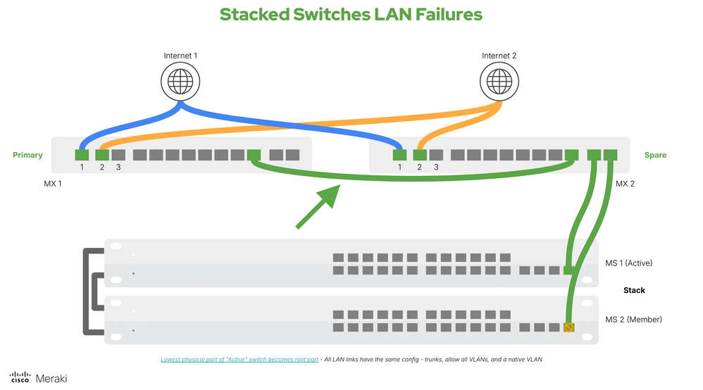

The only option at that point is to connect the MXs to each other directly so there's a remaining path for VRRP.

Need a little clarification regarding this please . If i provide directly path for VRRP on LAN 3 on both MXs (LAN 1 and LAN2 connected to the stack), when LAN 1 and LAN 2 is disconnected VRRP message will flow through LAN 3 and how failover in this case will be triggered?
Ryan_Miles
Meraki Employee All-Star
VRRP is sent on all links and all VLANs. So yes, in that example of losing LAN 1 & 2 LAN 3 would still carry VRRP packets between the MXs and keep MX1 as primary and MX2 as spare.
Traffic flow of clients downstream would be from the switch up to MX2 then over to MX1 as that would still be the primary unit in the HA pair.

Thank you for your answer. So if i understand good, secondary MX2 will start to answer on LAN virtual MAC address even it is in spare state?

If the MXs are directly connected to each other MX1 would remain primary and therefore retain answering to the virtual MAC.
MirzaDz
Hello,
Ok, but MX1 lose LAN connections to the stack. So traffic from client pointing on LAN virtual MAC address doesnt have path to the MX1 if i understand good.
Ryan_Miles
The path to MX1 is through MX2
