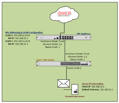

Documentation states : Special exceptions are made for DHCP discover messages and for traffic used to synchronize information between MXs in a NAT warm spare configuration.
https://documentation.meraki.com/MX/Firewall_and_Traffic_Shaping/IP_Source_Address_Spoofing_Protecti...

Wait - what? An MX doesn't forward DHCP between it's Internet port and LAN ports. The DHCP as shown in the drawing is only for the MX's Uplink. DHCP for clients downstream is handled by the MX itself. You'll need to configure a DHCP server on the VLANs configured on the MX.
RaphaelL
DHCP is over the S2S VPN. This is a spoke.
rhbirkelund
Ah - that was not clear.
