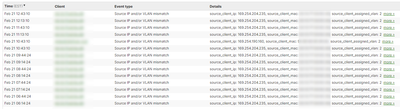

On some sites we have machines that have issues getting IP from DHCP.
We can see the MX dropping thoses packets with the event log :
Documentation states : Special exceptions are made for DHCP discover messages and for traffic used to synchronize information between MXs in a NAT warm spare configuration.
Has anyone ever encountered issues with RPF ? We have 1000++ networks , I'm pretty sure that I can find couple other examples.

Same topology as the documentation. MX receives the DHCP discover , but drops it.

Wait. Shouldn't DHCP discover packets be sourced with 0.0.0.0 ? I might have to read the RFC again
DHCP messages broadcast by a client prior to that client obtaining its IP address must have the source address field in the IP header set to 0.
https://www.rfc-editor.org/rfc/rfc2131
Well I think I found the issue. Thoses machines are sourcing their DHCP discover with an IP different from 0.0.0.0. Meraki support will confirm that. I will keep you guys updated.

I was right !
The IP source address spoofing protection is expected to block traffic from a device when it see's a source IP that does not match a known configured VLAN/subnet. In this case, the client device is sending DHCP discovers with a source IP address of 169.254.x.x instead of the expected 0.0.0.0.
A client should not be sourcing the DHCP discover using the APIPA address, as that goes against the standard set forth in RFC 2131:
"DHCP messages broadcast by a client prior to that client obtaining its IP address must have the source address field in the IP header set to 0."
So it is an expected behavior ! I will have to investigate why our HVAC windows machines are suddenly doing that.

There are 4 ways to 'solve' this issue.
1- Contact your vendor and let them fix the DHCP issues ( Will take forever )
2- Update the firmware , OS of that alarm controller ( if this is a known issue on their side, it might be already fixed )
3- Set the device in IP static ( not ideal )
4- Disable IP Spoofing ( not ideal either )
We ending up rebooting and factory reset our defective machines and it is now working fine.
