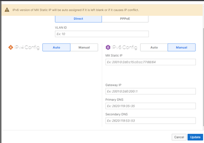

Hi,
I just upgraded my MX68 to 17.6 (thanks for adding IPv6!!!) and wonder how I can set my WAN port to use Auto (DHCP6)? It shows as Auto (Stateless).
I am connected to Starlink, which should assign me a couple of prefixes I can then delegate to my Vlans..
Edit: looks Starlink disabled IPv6 very recently  (at least in some countries), not sure if this explains the behaviour..
thanks!

If the service was removed or disabled for a certain reason, try to set it to an automatic mode and you will see when it is back again. DHCPv6/PD is most common. But there are other ways like 6to4

Thanks for the reply. I checked this link, it shows that DHCP6 is supported, but doesn’t say how to configure it. But maybe the MX detects it automatically, difficult to say as Starlink seems to have disabled IPv6..
