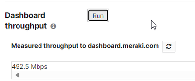

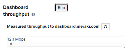

I'm struggling to understand why our MS-225 has a significantly slower "Dashboard Throughput" speed versus the MX85 that it's connected to. When I test on the MX, it gets a consistent 490+Mbps speed which is accurate for our WAN link, however when doing the same test from the switch (Tools-Dashboard Throughput), it's roughly 12-15Mbps.

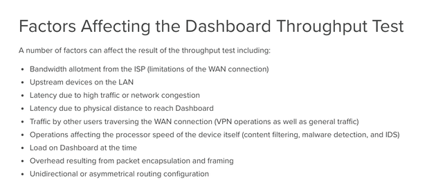

Throughput test to the Cisco Meraki Dashboard
RWelch
This tool can be run from any Meraki device that is currently connected to the Cisco Meraki cloud. This live tool is designed to test the speed of communication between the device and Dashboard. It is not meant to accurately test the speed an Internet/WAN link is capable of.

You are testing from a device with a very small CPU that is not built to generate and receive large amounts of traffic. IMO, this test is entirely meaningless on internal devices.
This is the answer.  You are measuring a difference in CPU performance, not Internet performance.

Noted that too. Dashboard throughput test with switches is useless for testing internet speed. Its capped around 10 to 15 Mbps.
In my case an access point behind the switch shows up the same value as the mx.
