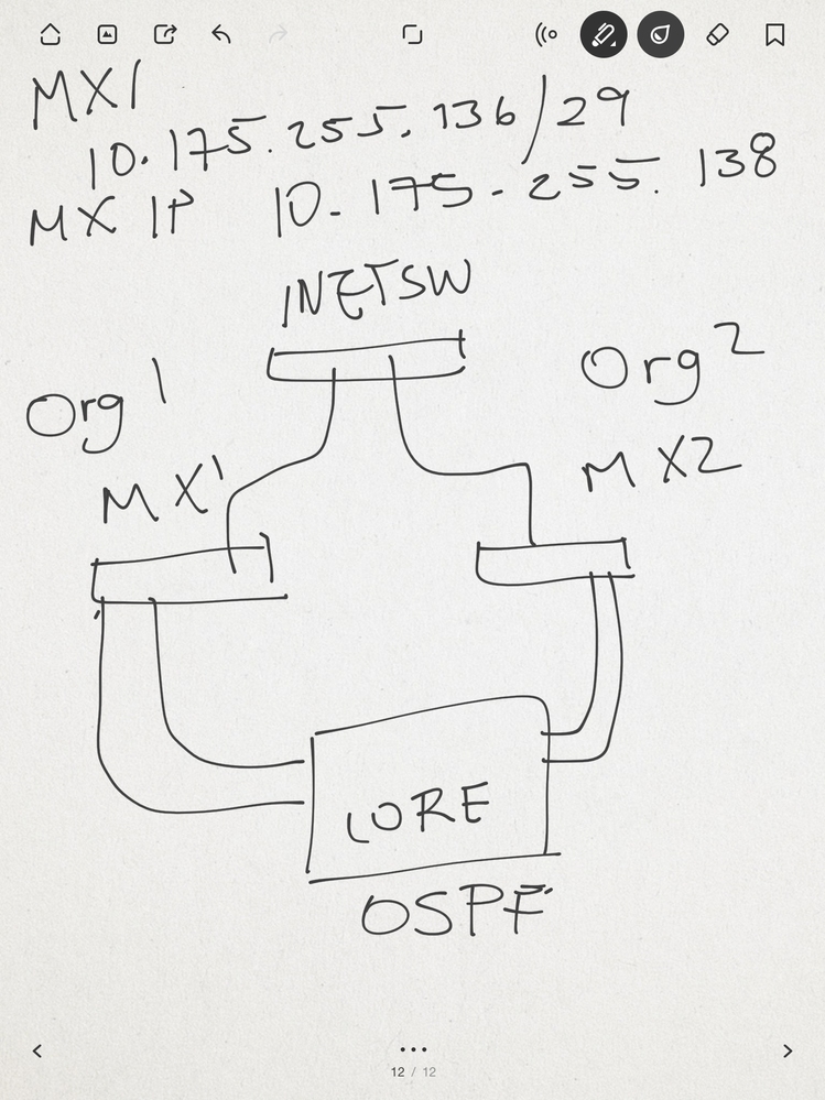

I still don't clearly understand what you are trying to do.  Could you attach a diagram (even something hand drawn and take a photo of it)?

Let me try to explain myself again.
Currently MX1 is up and running it has IP segment 10.175.255.136/29 and the LAN IP address 10.175.255.138 interface 1 and 2 are connected to my CORE Switch connected to interface VLAN 2102, here is the configuration of the VLAN 2102 at the CORE:
interface Vlan2102
  no shutdown
  ip address 10.175.255.137/29
  ip router ospf 1 area 0.0.0.1
Now I want to connect to my CORE a new MX (MX2) also connecting Interface 1 and 2 in the MX to the CORE,  my question is for this new MX can I assign IP segment 10.175.255.136/29 LAN IP 10.175.255.139 and setup the ports in VLAN 2102 same as MX1 or do I need to create a new Interface VLAN and add that to the OSPF that I have
MX1 belongs to a different organization and I will setup MX2 to a new organization.
Also MX1 it is setup as a Hub for site-to-site VPN and I will setup MX2 the same way
MX1 and MX2 will have different Public IP Addresses
I'm also adding a hand writing diagram:
Re: MX Configuration
Yes, you can re-use the existing VLAN (and setup the ports on your switch the same), and yes, just use a new free IP address such as 10.175.255.139.
