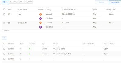

I've a very simple network, with only 2 vlan
No rules on firewall outbound  and authentication with meraki cloud
From few days, VLAN10 is not reacheable from client. The connection is ok, VLAN20 ok but when I try to connect or ping something in vlan10 I received connection error but the remote gw 192.168.0.100 respond correctly. I try to update firmware but I don't find any solution.

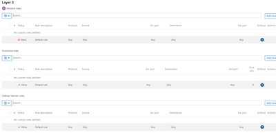

Have you got any firewall rules configured on the Meraki side?

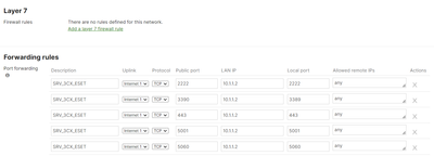

Thank you for your response. No there aren't rules on fw, now is very simple. I've tried with windows firewall but nothing changed. The problem started last week, when new version was released but no installed. Now I've found that services in vlan10 are not reacheable from outside, but services in vlan20 are ok. I attach port forwarding. As usual nothing and no one intervened, but now it doesn't work.
