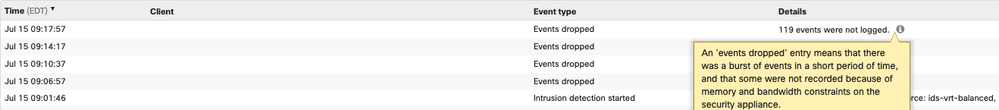

Adding to this, I enabled AnyConnect on a unit that normally doesn't have it running (my personal MX) that I also upgraded to 16.9 and the service doesn't seem to be coming up (it's been about 20 minutes).
Checking the event log, I see no mention of AnyConnect starting, rather, I'm seeing these suppressed log message notifications:

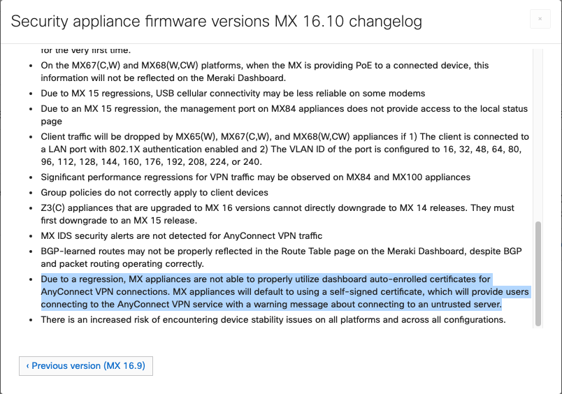

With 16.10 out now, I checked the Release Notes to see what was still broken, it appears this is, along with the VPN performance hit that appeared in 16.4, so I guess I"m skipping this one.
MX 16.12 seems to be out. Did not see the cert issue in the release notes any more and the cert seems to get created correctly (had issue with 16.10, now gone after the upgrade). Seems to be issued by "HydrantID Server CA 01", no more self signed.
Yes, the issue was fixed in 16.11.
Of note, 16.12 has some significant improvements, including VPN throughput that makes it a worthwhile upgrade.
