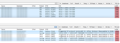

Hi,
It seems that Meraki has changed the ESP overhead size from 64 bytes to 68 bytes if you are running MX 18 ++
This may affect IP Fragmentation as shown below.
This is a capture done on MX15.44.
Client sends a maximum of 1408 UDP payload + 20 IP header = 1428. Then you add the encryption + 64 bytes = 1492 MTU , this fits almost any normal WAN link ( DSL and fiber and other )
( top is 'Internet' capture , bottom is AutoVPN capture )
With MX18++ 1408 UDP payload + 20 IP header = 1428 if you add up the new 68 bytes = 1496 !
DSL links might not like that number ! We have encountered some ISP that instead of fragmenting those packets , they were simply dropping them.
I haven't seen any documentation / changelog regarding those 4 new ESP bytes ,  but the 68 bytes is now included in the MTU troubleshooting guide

1506 - 14 L2 header = 1492
1492 - 1428 = 64.  Same test ran with MX18 will give you 68 bytes.

We changed the MTU of a MX ( running 18.107 ) HUB in a lab from 1500 to 1468.  The advertised MSS is now 1360 ( 1468 - ESP overhead - IP - TCP = 1360 )
Taking a packet capture shows ESP payload of 1400 bytes and total WAN packet lenght is 1474. 1474-L2 header = 1464. Which again gives a ESP overhead of 64 bytes instead of 68 bytes.  That's curious.
There is something funky going on or I'm missing something obvious written in a RFC older than me.

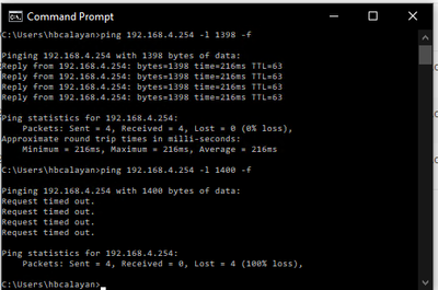

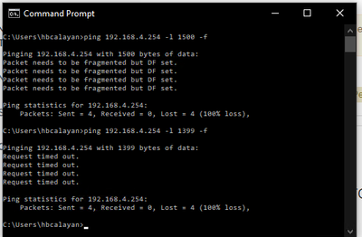

When i tried to ping the spoke MX with 1500bytes it gives the packet fragmentation message w/c is expected. But when i tried around 1399 up to around 1450 bytes, it just timed out.
Edit: 1398 works but not 1400 is timed out
Edit: I have 2 different spokes MX here with different behavior when i ping with 1500bytes
