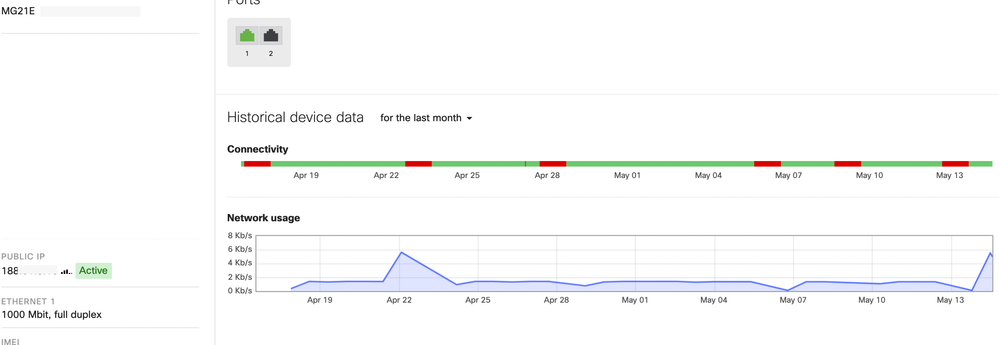

We are using an MG21e and MX67 in a combined network.
Lan2 port on the MX is configured as a secondary WAN (Standby) and goes to a POE injector first before going into port 1 of the MG.

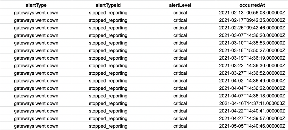

Over the last 3 months we've had the MG go offline 14 times and counting. (only started counting after we setup webhooks)
Meraki support told me that it might be some blocked ports, but after checking with the provider they confirmed that there are no blocks or restrictions of any kind.
When it's connected to the network it also seems to have a pretty good connection 66,3Mbps.
The really weird thing is that the connection loss seems to happen right around the same time.
Same for it coming back online, happens around same time of day.
Anybody has any idea or other steps to take?

Screen Shot 2021-05-14 at 12.34.22 PM.pngScreen Shot 2021-05-14 at 12.36.01 PM.pngScreen Shot 2021-05-14 at 12.36.27 PM.png
