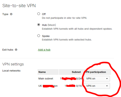

cmr
Under Security & SD-WAN got to the tab below and check which routes are advertised over the VPN, if your default route is here then change it to VPN off in the circled drop-down:
Hudson_J
Thank you guys for the input.
I've found it by following your thoughts. It's about the routes and mis-configuration of Exit Hub.
Thank you all.
