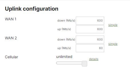

The two wan links are configured as below:
