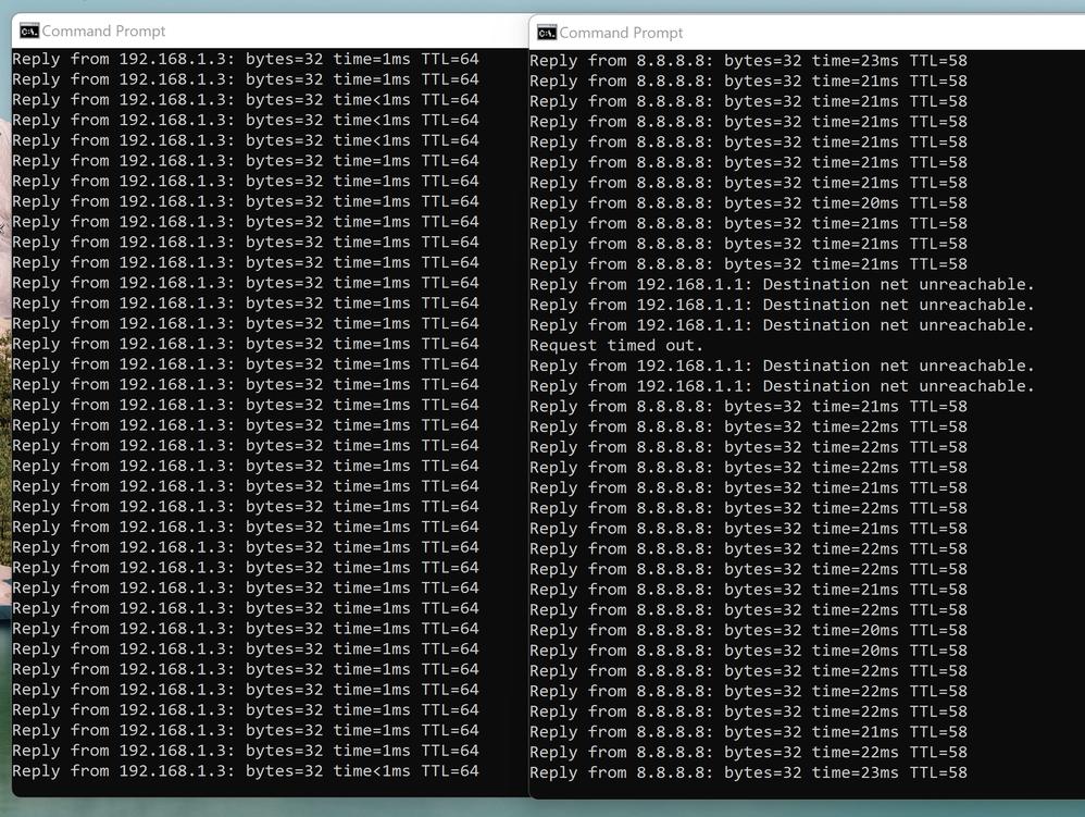

To clarify, if I ping my local NAS drive (that is connected on the same switch as my Meraki MX64) then there is no packet loss. If I ping 8.8.8.8, then I have packet loss. If I connect another laptop on the same lan cable, the packet loss to 8.8.8.8 goes away. If I move the XPS laptop to a different lan connection, I still get packet loss to 8.8.8.8. Also if I connect the XPS to a D-Link router with 4G mobile internet via the same docking station, then the packet loss to 8.8.8.8 goes away. I have also tried a two other docking stations with the XPS and the packet loss still occurs when connected via the Meraki.

Nothing works, the internet connection remains intermittent for this one user on this one laptop and nowhere else. I add a screenshot of how we ping a local NAS with no packet loss and 8.8.8.8 with packet loss at the same time.

I'm not sure if this could be a cause but the MX64 is meant for 50 users or below.  You could be running into transient issues because the device is overloaded.
You should also run a pcap to see if your device successfully sends ARP requests and receives ARP replies every few minutes from the MX since ARP entries do timeout after a while even when using a connection actively.
