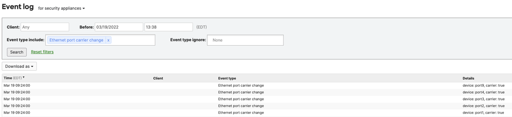

Well, we had one day of nothing happening and then it started again.Checked the logs more thoroughly this time and saw that all ports that had a link on them had flapped. Odd. I searched specifically for that and saw that this appeared to be happening at least once a day.I opened a ticket and they apparently saw some issues in the logs and told me they were sending me a new unit. Excellent I thought.
So, installed the new unit and figured I'd check the logs to ensure that this error message was gone. It wasn't. I was seeing the exact same thing with the replacement unit:

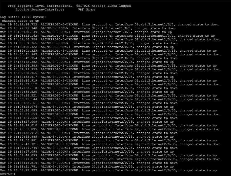

Support didn't seem concerned because the customer hadn't complained yet, but I logged into the 2960 stack that's one of the units behind the MX and it was showing its uplink being connected/disconnected when I see the flap in the MX logs, so clearly, this is still actively taking place (GI1/0/1):

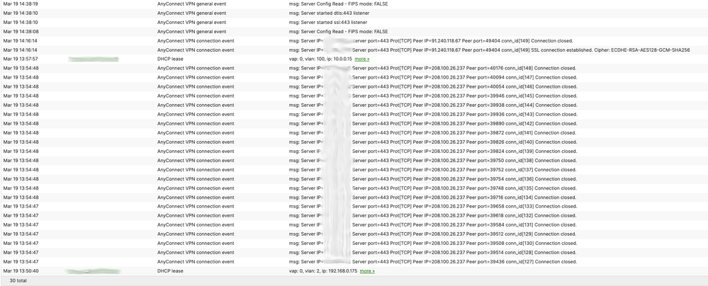

Then I noticed that the AnyConnect service seemed to be restarting at the same time:
Also, because of the use of the default, port, the AnyConnect service was getting hammered by foreign IP's and this appeared to be triggered it to restart:

If your MX wan interface is connected behind your 2960, check if the switch port has energy-efficient ethernet enabled, if it is, try disabling that feature and see if the MX port will still go down. Good luck
I have 4x 2960's behind it, one as a 3x stack, one as a standalone for a separate network. There's also a cheap Trendnet PoE 100Mbit switch that runs an Aruba AP for guest WiFi on its own VLAN and it uses a rate limited WAN link on WAN2 at 10Mbit.
None of the 2960's have energy efficiency enabled and the MX flaps ALL the active ports at once, which you can see in the screenshot, that includes both WAN links (which are connected to an Alcatel/Lucent ALU for fibre) and all three LAN links.

I don't see any connection between the two services. But, if really someone is sending too many requests to your MX on port 443, (based on what they are doing), your MX may run out of memory and eventually panic, which would explain AnyConnect Restarting and ports are flapping. If this is true, you shouldn't hear any complaints this week since you are using a different port. Also, you may set AnyConnect to use port 443 again but connect a switch between your ISP and the MX to mirror the uplink port of the MX and check what kind of traffic is sent to the MX on port 443. Please let us know what you find, this is really a strange problem.
