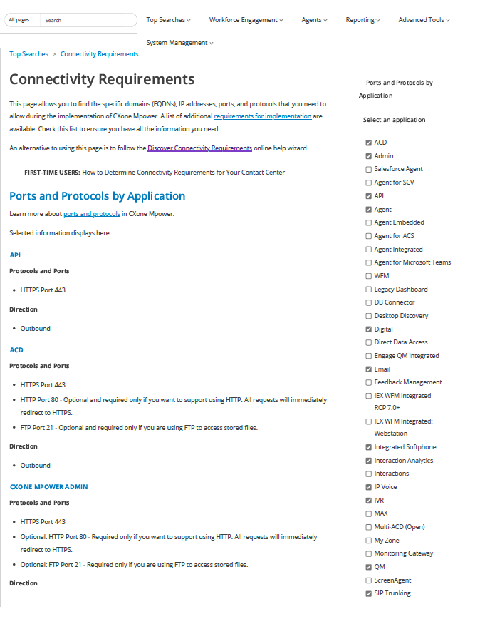

I know this comes up a lot, but I still struggle with making sure our services will work.  With Meraki blocking all inbound traffic by default, how can I go about making sure a long list of FQDNs wont potentially get blocked?  We are implementing a new cloud voice contact center solution and the provider gave us a list of 70+ FQDNs that they say must be allowed.  I called Meraki support and we discussed the new Early Access feature called NAT Exceptions with Manual Inbound Firewall.  Aside from some new feature set that I am not familiar with, what do other admins do in these situations?

Thank you for your responses, greatly appreciated.  Sounds like I'm off to a good start with an Umbrella list for DNS/Content.  If you are curious, I've attached the requirements.  Look at that long list.2025-04-02_10h23_25.png2025-04-02_10h23_44.png2025-04-02_10h23_57.png2025-04-02_10h24_08.png2025-04-02_10h24_19.png2025-04-02_10h24_30.png2025-04-02_10h24_37.png

I can't  be sure this is the specific flavor of CXOne we have, but we use CXOne for our Contact center users and we are all remote and have not had any issues with the myriad of firewalls our employees have at home. You should hopefully be good with what you have done.
