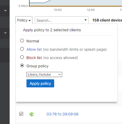

I do have several Group policies setup and the laptop in question is configured for one of these policies. But I must add that the Group policies are assigned by MAC adress and as the VPN is not using the MAC address of the LAN port on the laptop, I'm not sure that the Meraki will identify the laptop correctly. That being said I'm not interested in using the internet throught the meraki. The laptop can use it's own local internet as long as I can access the LAN on my office network.
Well, I suggest you try putting the machine on the allowed group policy and test again, It's not a route problem and probably a rule on your group policies are blocking the connection.
ErnstTFD
I use MAC addresses to add clients to a Group Policy. The VPN connection does not have a MAC adress. How will I add a policy to it?
Has the client connected to VPN right? So you can add to a Group Policy.
Group Policies
It is possible to manually apply group policies to clients connected via client VPN. Group Policy applied to a client VPN user is associated with the username and not the device. Different devices that connect to client VPN with the same username will receive the same group policy. For more help on assigning or removing group policies applied to a client, refer to the Creating and Applying Group Policies document.
Note: It is not possible to assign group policies automatically once a user connects to client VPN.
