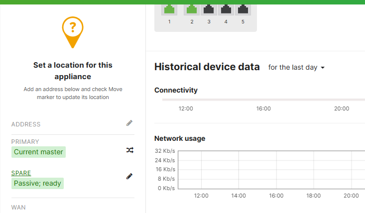

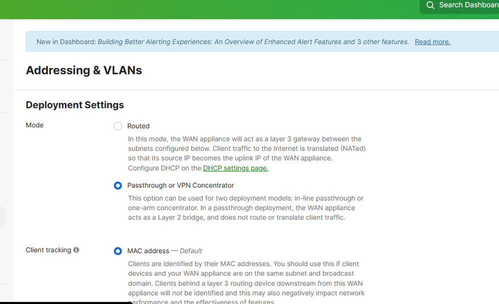

I have two Meraki firewalls configured in High Availability (HA) mode, with their operational mode set to "Passthrough or VPN Concentrator."
When I connect devices to both the primary and secondary firewalls simultaneously, the devices work normally and receive IP addresses without any issues. It seems that the secondary firewall does not block any ports or interfere with the traffic in this setup.

If the MX'es are in Passthrough Mode, you should only connect one port to the network. In Passthrough mode the concept of Internet port and LAN port goes away, as both MX'es are only connected to the network via the Internet port. Any other port connected to the network besides the internet port, would result in some unexpected behaviour, and should be avoided.
In the first screenshot that yo've shared I see port 2 as up. You should disconnect this port.

  • In a VPN concentrator deployment, you only have a single WAN port connected.
  • In a passthrough deployment, the MX acts like a simple layer 2 bridge.  It works inline.  Think of a network where you want a firewall but can't change the IP addressing.  So you might slip this in between the default gateway and the internal devices.
    • I have never done this type of deployment.  I don't like the sound of it.
