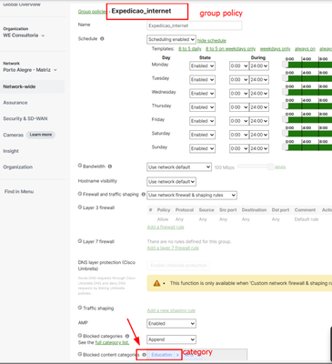

I am encountering an issue while configuring content filtering on our Meraki. We have a Group Policy named "expedicao_internet", which applies category-based blocking.
Currently, we are blocking the "Education" category within this policy, but we need to allow specific URLs within that category without disabling the category-wide block.

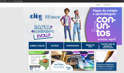

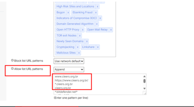

The problem is as follows: when I add the site cieers.org.br to the Allow List within the Group Policy, it does not get unblocked. Even after adding various domain variations like:
The site continues to be blocked. However, if I remove the "Education" category from the policy, access to the site is correctly allowed.

I opened a ticket with support and am waiting for a response. However, the situation is quite strange. The configuration appears to be correct, and the block is coming from the category itself because if I remove it, the site becomes accessible. But when I add the category back and put the site on the allowed list, it remains blocked. 😞

I had a similar issue in the past and putting all of the URLs in the allow list alphabetically helped resolve my issue.  Not sure if that is the case with your scenario.

Do you add URLs like this:
facebook.com
*.facebook.com
? Is there any trick to this? In other firewalls, I have always used the asterisk, but in Meraki, this also seems to have some particularity.

The asterisk symbol has two primary uses in URLs for content filtering.
  • Standalone Catch-All Wildcard
    • The " * " (asterisk) symbol when used on its own line is an all-inclusive wildcard which represents all possible entries
    • When used on its own line in allow listed URL patterns, ALL URL patterns are allow listed
    • When used on its own line in blocked URL patterns, ALL URL patterns are blocked, except those that are explicitly allow listed
  • In-URL Asterisk Character
    • The " * " (asterisk) symbol when used as part of a URL or in line with a URL is simply a regular asterisk symbol and is interpreted as part of the URL, NOT as a wildcard
    • Note that this is very rarely useful, except in URLs that actually require asterisk symbols, such as https://web.archive.org/web/*/meraki.com
If you found this post helpful, please give it kudos. If it solved your problem, click "accept as solution" so that others can benefit from it.
When you make changes like this, they only apply to NEW TCP flows being made by the client.  Existing flows keep the existing settings.  As a result, it can take 10 minutes for you to see the change if you use the same test machine.
