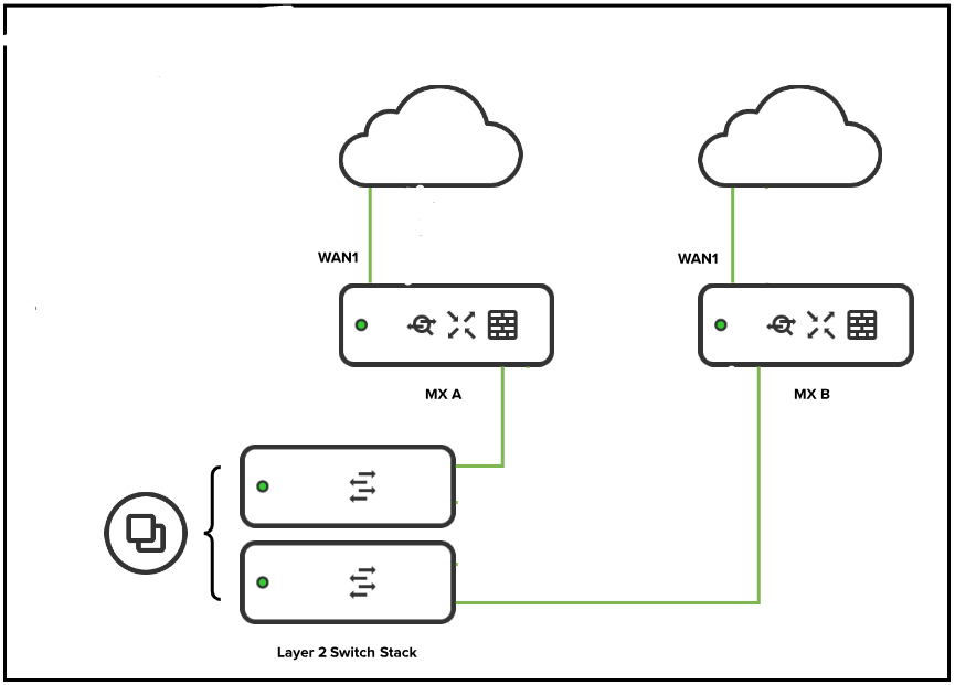

I've a site with 2 x MX68's running MX 18.107.5, with one WAN link in each and both connected to a Cisco switch doing layer 2 downstream, as per the diagram below.
Switch 1 went down, but the MX68's didnt not failover. Pretty sure it did in the past with MX 17.x.x.
Any ideas why it would do that?

Assuming that the primary MX68 lost LAN connectivity when switch 1 went down, then yes a failover is expected.
Is the above diagram an exact match of your topology?

Thats what I thought too.
The diagram is exactly the same as the topology.

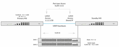

In this design that you are using, it is recommended that the port be and access mode.

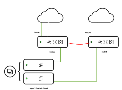

So what I suggest is to make a direct connection to each MX. You can create any VLAN (999 for example) and define any IP /30 for both MXs (Ex. MX1 169.168.0.1 and MX2 169.168.0.2), configure a port on each MX in that VLAN and make a direct connection like the image below in red.
Something like this.

I've seen this design and was under the impression that Meraki dont recommend cabling them like that anymore.
But I'll give it a try in a lab.
