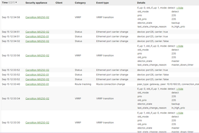

We have 2 MX-250 firewalls that are in HA, today we got alerts saying that  "Failover event detected" When we checked in the Appliance status> historical data> uplink pages we didn't see any drops or red alerts on historical data but I can see the VRRP events in the Event log page.
Could someone help me understand why we can't have any drops or red alerts on the Appliance status page?

A VRRP event does not mean that there was any drop at the time.
Did you check if there was any link failure and if the MX was unavailable at any point?
What are the VRRP transition values presented in the logs?

Once we received the alert notification we checked if there was any uplink failure or not, I don't see any uplink failure in the appliance status. Please find the Attached the VRRP event log below.

I noticed that there were events on ports 25 and 26, port carrier usually means a layer 1 problem, so it would be interesting to check if the cables are ok.
