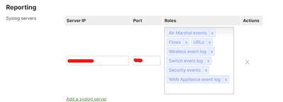

I am trying to get decent content filter and firewall log info but having a hard time. The meraki event log truncates the details so you cant see most of the message.
Everyone said to send the messages to a syslog so I set one up (Kiwi NG), however I am not seeing any content filter stuff and a suspiciously small amount of data in general.
I have selected everything possible in the meraki setup
but in the syslog server, in the last 24 hours there have been only 113 messages from 13 AP's - but we have nearly 80 AP's at this site and hundreds of staff.
The events are all flows or urls. Every flow is an allow (I cant believe there hasnt been a single block ).
Also - are the flows essentially the firewall rules? the message doesn't include any firewall rule name which is a major inconvenience and makes it very difficult to config rules to filter the logs for better clarity.
Also - theres no sign of any content filter events - are these the url events? If so, it looks like the messages are truncated at the same point they are on the dashboard 😞

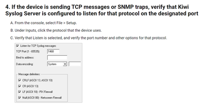

It's probably a configuration issue in Kiwi Syslog.
Take a look at the documentation.
https://documentation.solarwinds.com/en/success_center/kss/content/kss_gsg_troubleshooting.htm
https://documentation.meraki.com/General_Administration/Monitoring_and_Reporting/Syslog_Server_Overv...

mmm i thought about that, but there really isnt much to configure. You just enable inbound UDP messages and tell it what port to listen to.
And its clearly working to some extent as its received 113 messages - but only from 13 APs out of 80 😞
It would be interesting for you to double check. In your place I would validate these two parts.
I've had similar problems and the problem has always been on the Kiwi Syslog side.

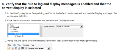

im using their shiny new "next generation" version 🎉 which significantly simplifies the interface and config. Iv already gone through their documentation and made sure the default rule is enabled and all that jazz.
ill try another logserver 😕

so events seem to be flowing in now - however I don't seem to be receiving anything from the security appliance (all roles have been selected in syslog settings).
I can see flows, urls, switch event log - but nothing from the appliance (specifically content filtering). I checked in meraki event log and can see that there are filter events all the time.
Do I have to enable something like I did for the firewall rules?
