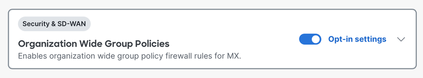

Not sure when it became early access in the dashboard but I just noticed it.  Recall reading something about it earlier.
Organization Wide Group Policies
Enables organization wide group policy firewall rules for MX.

RaphaelL
I enabled it earlier this week and I'm not too impressed.
At the moment it's org-wide group policies firewall. The configuration is a bit confusing and not too user friendly.
But I'm sure it will improve overtime !

To be clear, this DOES or DOES NOT require any Secure Connect or Secure Access connectivity.
Is this a merger of the L3/4 firewall rules or does this also include group policy settings like content filter.  And when you enable that do you still get the group policy overrides locally?
GIdenJoe
So I checked it out a bit but I don't have an MX supporting 19.x so I can't really test it but I noticed following:
This only pertains to the MX firewall rule settings including L7 NBAR based rules alas excluding countries...
So I believe (correct me if I'm wrong) all the content filtering is still done the regular way using local per network settings and local group policies.
RaphaelL
Correct !

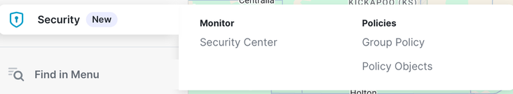

RWelch
After enabling (opt-in) Organization Wide Group Policies, the header at the top of the browser indicates Cisco Plus Secure Connect.
I've yet to see in the document where it elaborates - likely because it's an early beta (trial).
Ryan_Miles
Meraki Employee All-Star
Yes the browser tab name needs fixing
