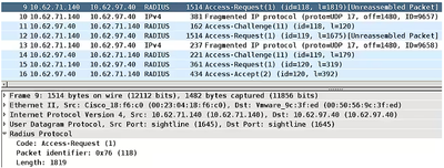

We encountered some clients with issues with 802.1X auth as the packets were fragmented. I'm talking about IP fragmentation and not radius fragmentation.
Something like :
Hard capping the MX MTU to something lower ( eg : 1492 ) "fixes" this issue.
Could we have fixed this without clamping the MTU ? I hate doing that cause it affects all MX from the same AutoVPN domain ?
I have not directly worked on that issue , but I have a hard time understanding how/why is ISE not doing the IP reassembly. I mean,  IP frag is a nightmare , but shouldn't have been a problem here IF all packets were recevied ( I don't have that info right now )

Are you balancing the links?
It is not uncommon to see RADIUS load balancing issues with EAP-TLS related to fragmentation.
1) failure of load balancing to reassemble large RADIUS packets, for example, TLS with larger key sizes.
2) dropping of fragments by load balancer that are deemed too small.
That's one more thing to check when I get back from my vacation if LB ( F5 ) are dropping the fragmented packets. It is the only thing statefull in the path. No firewalls in that flow.

I also have seen issues on other type of servers and also azure doesnt like fragmented udp.
I would rather have a lower tunnel mtu then troubleshoot al the other issues you get from fragmenting vpn tunnels.
